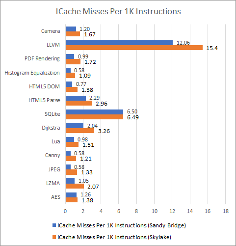

Sure. Using:
Event 0x83, umask 0x01 = "instruction fetch tag lookups that hit in the instruction cache (L1i). Counts at 64-byte cache-line granularity."
Event 0x83, umask 0x02 = "instruction fetch tag lookups that miss in the instruction cache (L1i). Counts at 64-byte cache-line granularity."
I also tried on SNB using event 0x80, umask 0x02 = "number of instruction cache, streaming buffer, and victim cache misses. Counting includes uncacheable accesses", and got slightly lower cache miss figures. So I'm not sure what's up with the "64-byte cache-line granularity" thing on SKL.
But at least the data mostly lines up, with LLVM stands out as really not fitting in L1i. SQLite and Dijkstra also have a few L1i misses.
Geekbench 4 instruction cache miss frequency

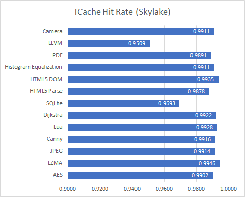

IMO fetch hits/(fetch hits + fetch misses) is a misleading metric because for a lot of these tests, the CPU's feeding the backend with the micro-op cache, and not even fetching from the icache at all. But here it is anyways:

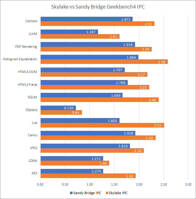

And finally, some Sandy Bridge IPC data:
SKL vs SNB IPC
